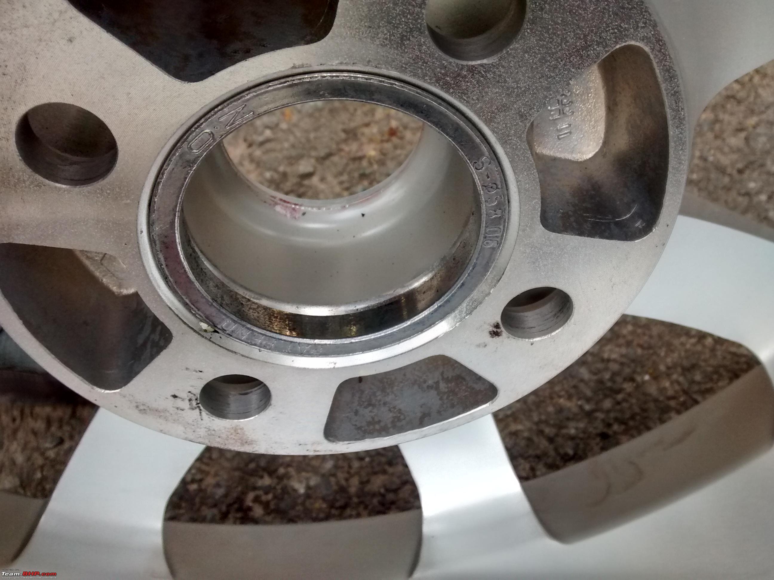

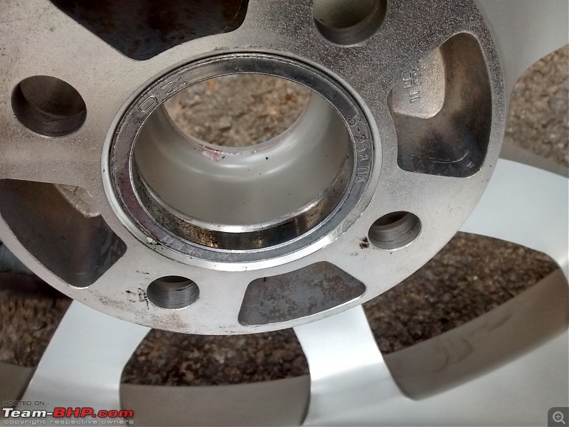

Most after market wheels are therefore made with larger hub diameters to ensure that they will fit on a wide range of cars. This means that when the wheel is installed, there will most likely be a space between the axle and the hub instead of a firm contact. The wheel is therefore lug-centric, as the wheel is centered by the lugs rather than by the hub. Driving on lug-centric wheels means that any impact will apply shear force to the lug studs, forces at 90 degrees to those the studs are designed to handle. This can cause the lug studs to bend, leading to a vibration in the car as the wheel slips around on the mounting plate. To prevent this kind of thing, after market wheels will usually need hub-centric spacers, small rings of metal or plastic made with various inside and outside diameters so as to fit inside the wheel hub and then fit over the axle, making a lug-centric fitment into a hub-centric one. Here is an alloy wheel with a hub ring or spigot ring inserted.

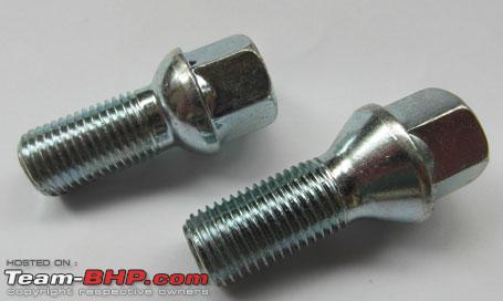

Let us now get to the meat and potatoes of this discussion. Even though we just spoke about hub-centric, in reality, it is the lug bolts that correctly centre the wheel. The hub and the centre bore of the wheel just takes us close to the centre quickly. If you have ever changed a wheel on a car, you would have noticed that the wheel fitting on the hub is mostly a clearance fit and is nowhere near to the precision levels required for accurately centring the wheel on the hub. The lug bolts do this, by having a tapering mechanism (usually 60 degrees for road car application and 45 degrees for racing application) called a cone seat, or a spherical mechanism, called the ball seat. These two are not interchangeable. Using a cone seat bolt in a ball seat wheel is suicidal. There is also a flat seat application, but is not very common.
This image shows a cone seat and a ball seat bolt

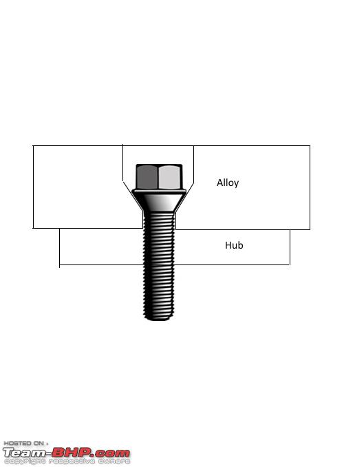

Here is an example of an alloy wheel of the same PCD as the hub.
Note that the bolts are also aligned to the PCD and the 60 degree taper in the bolt corresponds to the 60 degree taper in the alloy bolt hole. Let us take a closer look.
This is a depiction of an OE bolt used in an OE alloy. Since the taper matches correctly, the clamping force is applied evenly.
