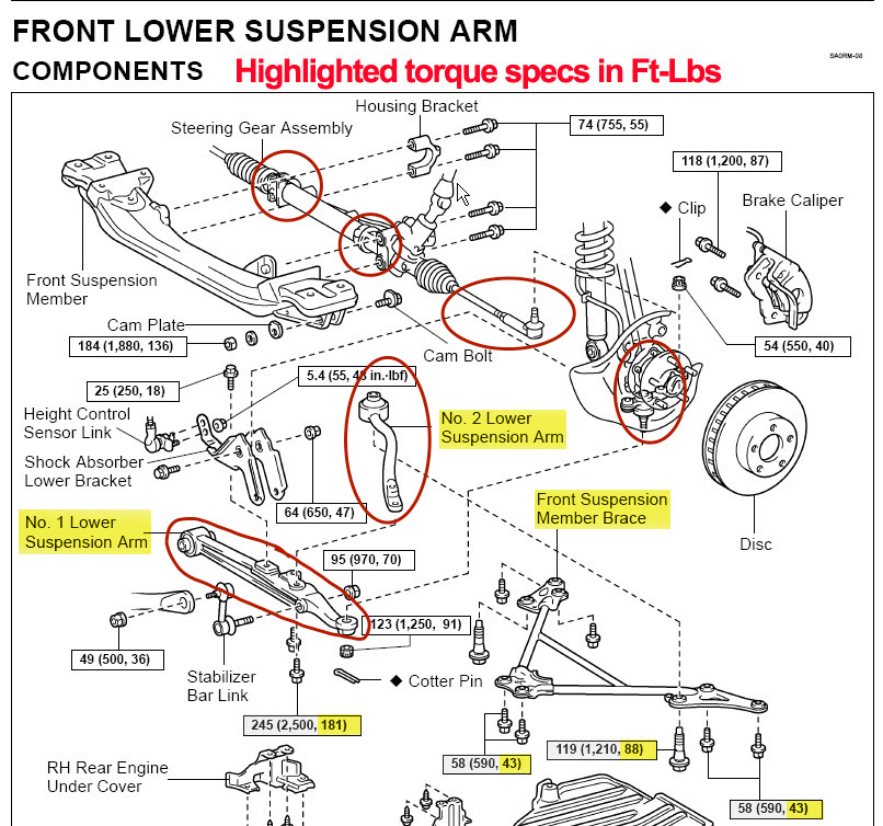

I Ordered the complete front end bushing and steering arms from the UK and should have it all by next week:
OEM no. 2 Lowers suspension arms with bushings
OEm no.1 Lower suspension arms with bushings
Poly Steering gear bushings
Japanese Ball Joints Upper and Lower
Japanese Steering rack arms with bushings (inner and outer)

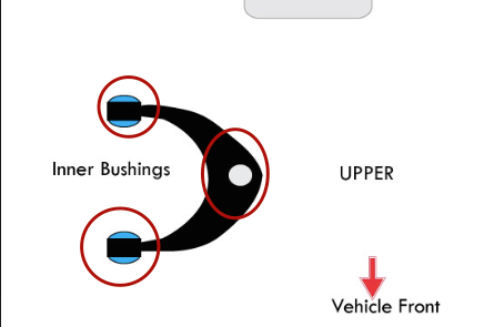

New Upper arm bushings
I want to do the whole front end in one go so I only have to have the car aligned once.
Ill post pics when all the new parts come in.

I received all the front end suspension components today and as I gesture of good-will they sent me a set of differential bushings for free:
I look forward to installing this in the near future.

dus, waar heb je dit allemaal besteld als ik vragen mag? ik heb die diff bushings ook nodig... Die bushings in de arms heb ik ook vervangen door TRD versies.. net iets stugger
The JoeZ intake (look-a-like) looks nice! Can you tell me what kind of parts you used for this mod?
Good call on the TRD bushings, they are a little firmer and should take a little more abuse.
When I swap the arms out (#2) I will keep the old ones for future plans of installing a permanent solution:
This number #2 arm bushing is a failure point on the front end of every lexus I have owned and I look forward to tightening up my is300 a little.
